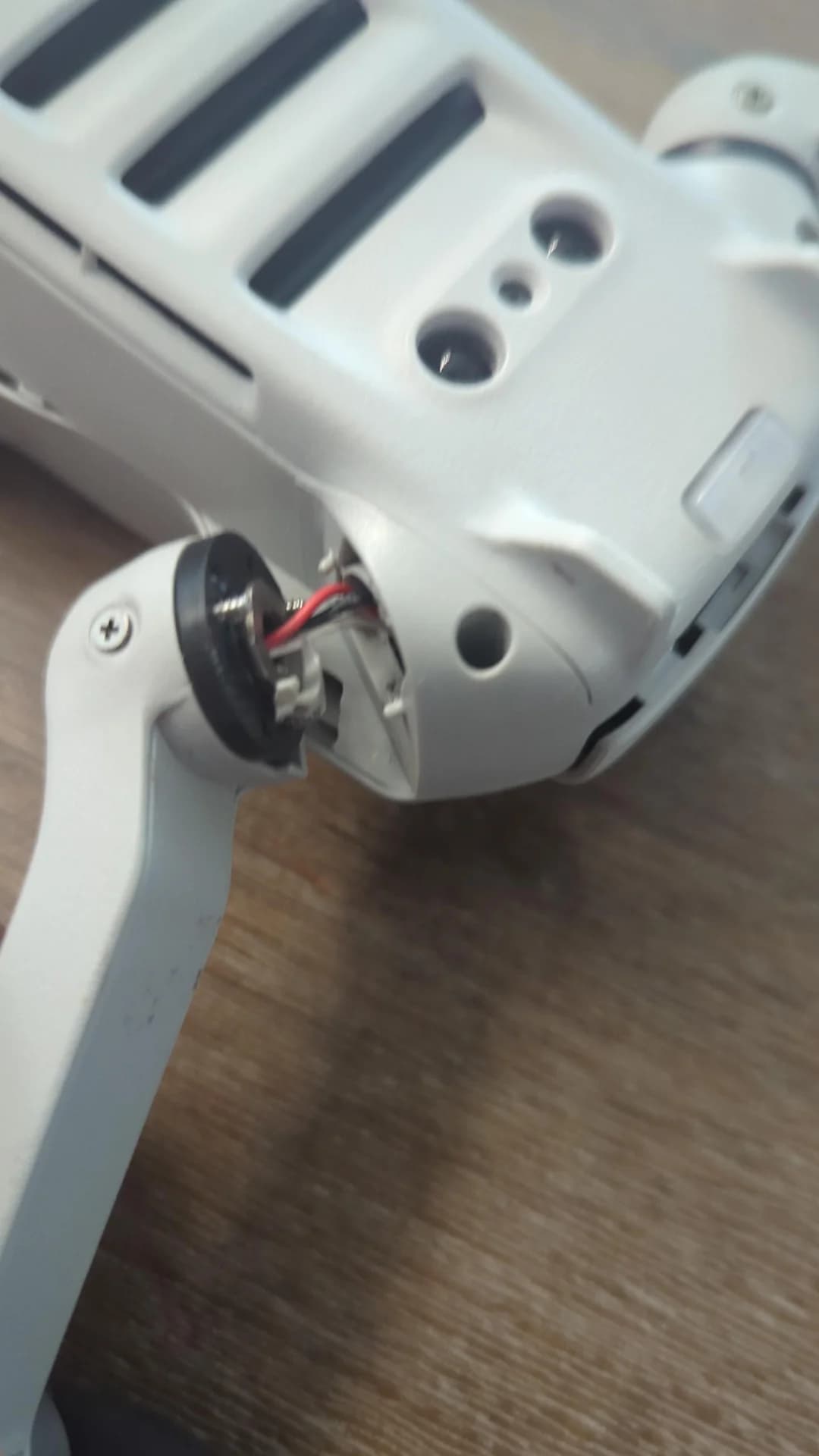

Crashed my drone… is it really beyond repair?
I don’t think I can fix this myself, so what are my next steps?

Hard to tell what’s actually broken, but if you’re okay with soldering, you can order replacement arms. I replaced one on my Air 2S for $35—just had to desolder six wires and solder the new ones in. Works great!
‘Beyond repair’ is when it gets run over by a car or sinks in the ocean and you find it days later. If you have the right parts, this is totally fixable. Or just send it to DJI—parts will probably be around $10, and the rest is labor and shipping.
