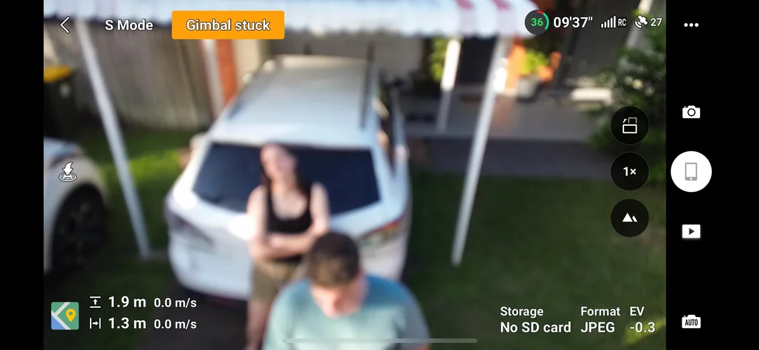

I recently bought a DJI Mini 3 from a marketplace, but the camera is blurry, almost like it’s not focusing. Has anyone dealt with this issue before? Is it possible to replace the camera if it’s defective?

The gimbal cover is definitely off. It does say stuck and suggests recalibration, but the gimbal moves freely, so I’m a bit confused by the error.

Are you absolutely sure the gimbal cover isn’t on? If not, could you upload a picture of the front of the drone so we can see?
It’s definitely not on, and the lens looks perfectly fine from the outside.
