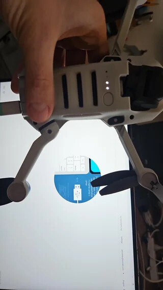

The drone is mostly intact, and I want to return it to the owner. I have some experience with cheap drones, but never with DJI.
It didn’t come with an SD card, just the battery. I attempted to connect it to a phone charger and the DJI app to see if it’s registered, but the battery doesn’t seem to be accepting a charge. Here’s a video of the situation.

Tried dji assistant without the battery and it looks like windows is not even recognizing it as an external device, thus not showing up in dji assistant. Not sure if it needs a working battery.
The two white LEDs flash 3 times, stop and do it again.

I managed to connect after fully charging the battery and turning on the drone. The DJI software allowed updates and downloading support logs, but there was no previous data.
