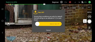

So here’s my problem—I bought a second-hand drone for cheap so I could fly with my son (he’s 8, and we both have zero experience). I tested it when I bought it, and it worked great. Tried again a week later—still fine. But today, when we finally went to fly it together, all I get is this screen. No matter what I do, the props won’t even spin when I slide to take off. What am I doing wrong?
When you slide that takeoff prompt to the right, try pausing at the end for a moment—it sometimes needs a second to register.

This is the screen im getting
Try pulling both control sticks down and inward to start the motors.

Tried that—still no luck. :disappointed:
When I power on the drone, the rotors do a little ‘click-click’ movement, so I think the motors are fine. Feels like some kind of connection issue. I’ve already updated the app. I don’t have DJI Premium, but I don’t think that should be causing this, right?

Wait… you mentioned ‘Premium’? That’s a big red flag. It sounds like you downloaded a fake DJI app. The official DJI Fly app isn’t available on regular app stores anymore.
Uninstall what you have and download the real app from DJI’s official site:
https://www.dji.com/ie/downloads/djiapp/dji-go-4
@Uma
Yep, I realized that too late. Turns out I downloaded a fake app. Grabbed the official one from DJI’s site, recalibrated everything, and now it’s working!
