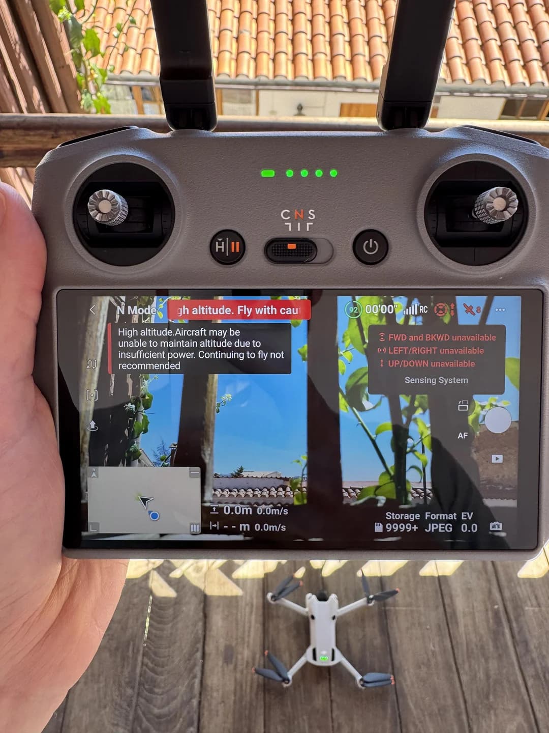

Sensing System Unavailable and High Altitude
Can I fly my Mini Pro 4 with these issues? I don’t want to take off if it’s not safe enough to get it back to me.
  1. The sensor is not available because your drone is currently not flying. It seems like you’re using a Mini 4 Pro?
  2. The drone has a maximum take-off altitude. You can check the DJI official website for specifics. If you’re in an area higher than its allowed altitude, you won’t be able to take off.

Yes, 2750 meters above sea level. Around 9000 feet.
@Shan
Then you absolutely can take off. I’ve double-checked the error message on your screen. It’s just a reminder that you are in a high altitude environment. Many things can go wrong, especially the motors have to work harder to maintain flight. This will lead to shorter battery life.
@Holt
Sweet! Thanks for the confidence boost! I just took off and didn’t have any issues!

I’ve flown fine at 2000m with a Mini 4 Pro like yours and have those messages as well. Flight times at 2000m felt similar to sea level.
The sensing system is off because the drone isn’t flying; that’s normal and should clear once you take off unless you’re in sport mode.
