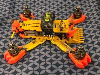

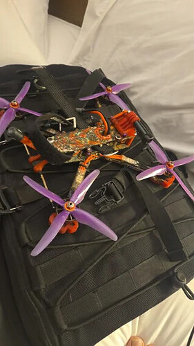

I’ve painted every drone I’ve built, even hydro dipped a few. Just use good spray paint and definitely add clear coat. I usually sand the parts first, apply a couple of base layers, then dip or add designs before finishing with 2-3 coats of clear. Wet sanding between layers gives the best finish. If you’re dipping, add extra clear for protection. Don’t forget to block off screw threads and places where parts meet to avoid paint build-up.

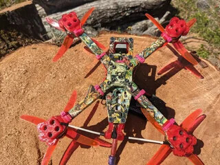

@Hollis
That looks insane! Did you really paint that or is it a wrap?
Teagan said:
@Hollis
It’s hydro dipped with about six coats of clear. It’s four years old and still holding up great!

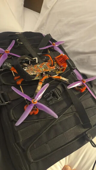

Don’t listen to that — custom paint jobs can last for years if done right! I’ve got nine custom drones and most of them still look great, even with a few battle scars.
