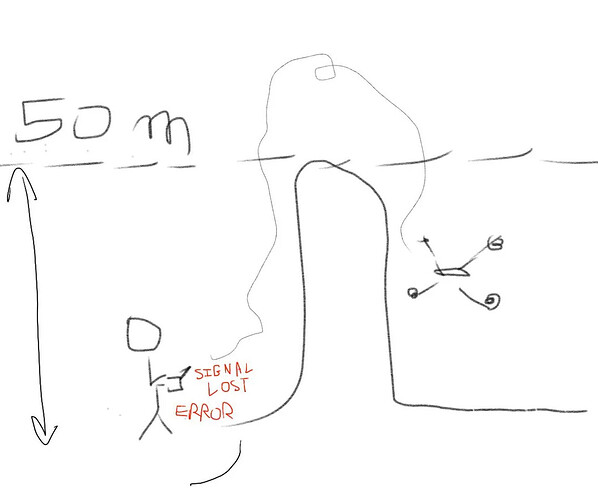

What would happen if I lose signal of my Mini 4 Pro behind a hill that is higher than 50m and my drone is triggering auto RTH? Would it bonk into the hill? Or go higher from its disconnecting point before trying to go back to base? Would its obstacle avoidance make it hover just over the hill? Sorry for my drawing skills :joy:
It depends on the lost signal option. I believe there are 3 options: Land, RTH, or Hover.
If you have RTH set to 50m:
  1. Drone loses signal.
  2. Auto starts the RTH.
  3. The drone will reach the selected altitude (50m in this case).
  4. It will then return at 50m.
  5. If it encounters an obstacle, it will try to avoid it, but since it’s a whole mountain, it might crash into something the sensors can’t pick up, like a tree or bush.
If you plan to try this, make sure to set the RTH altitude higher than the tallest building or mountain.

It depends on your RTH settings. Generally, it will lose connection, activate RTH, fly to the specified height, and return to you.
It’s not really a good idea (and possibly illegal) to fly your drone where you can’t see it, especially behind a large hill. The obstacle avoidance may try to take it over the hill but too close to the ground and hit a small tree branch, power line, or another hard-to-see object. You’d better hope it doesn’t crash into a car or person.
Best practice is always to set RTH higher than the highest obstacle in the area.

A hill, not a tower. Why don’t you set up the test? I’ll give my hypothesis: I believe that while the obstacle avoidance is on, the drone would try to go above the hill, trying to return to its takeoff coordinates. In winter, there’s a good chance it could crash into the top of the trees without seeing the branches. Good question though. I had my drone fly above my RTH height because of the thick fog that came in over the hill. I put it in forced landing mode and managed to get it back, but I was thoroughly confused for a moment.
Change the RTH setting to set your altitude higher than you think the hill is, and it will fly higher to return home.
Chances are it will keep attempting to RTH at your RTH altitude until it runs into critical battery levels, where it will perform a forced landing. It really depends on what the sensors pick up from the obstacle.
