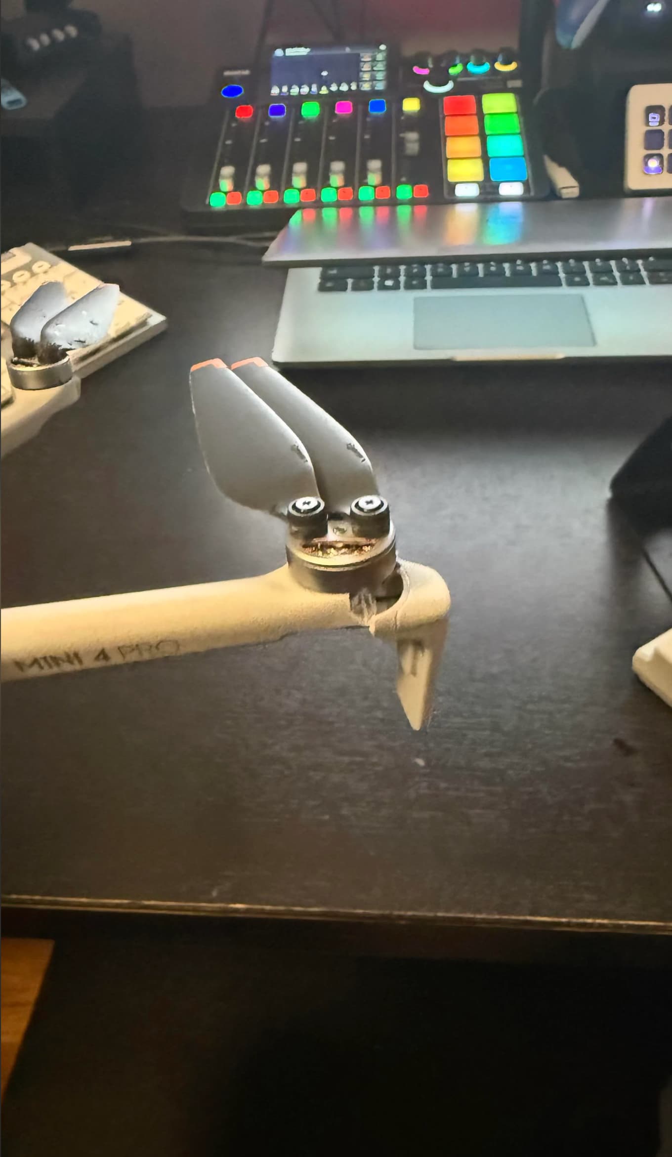

Wind speeds are around 17 mph today in my area, didn’t think that would be the biggest issue as I’ve heard 25+ is where things could get dangerous. I took the drone to about 100ft to try and get some landscape shots.
Immediately it started to drift, I began to rapidly descend to try and stabilize, the whole drone just shut down and fell from probably about 50 ft and landed in the grass. Ran over to find this.
Who do I call to fix this?/How much is this going to cost me?
Also, why would the drone just power down like that?
There’s a setting that stops the motors if you push both sticks down and at an angle. By default, it’s set to ‘Emergency Only,’ but it can be changed to ‘Anytime.’
If it was set to ‘Anytime,’ holding the sticks down for a few seconds would’ve killed the motors mid-air and made the drone fall.

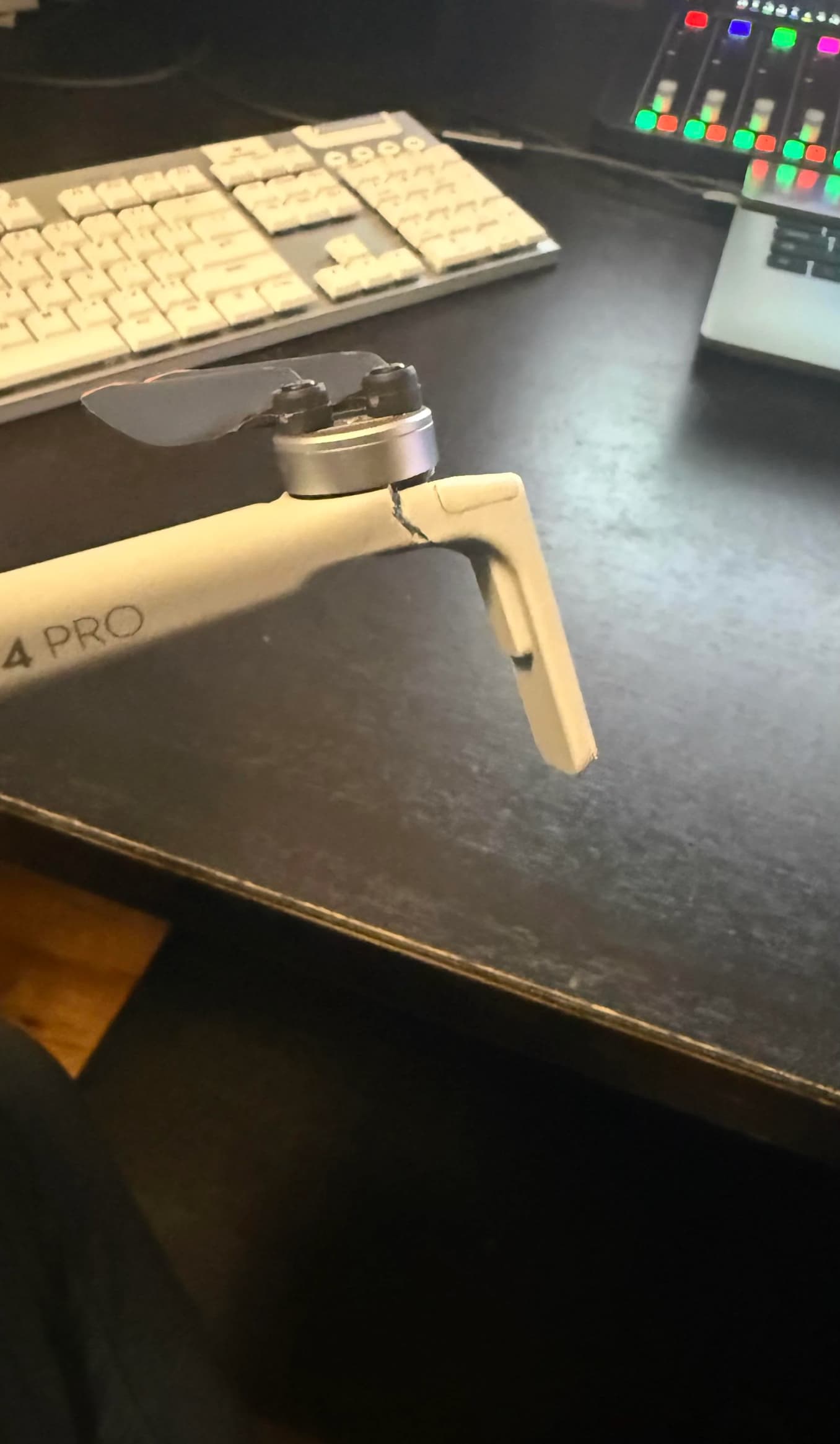

I do drone repairs in Orlando. If it’s just an arm, I can fix it for $100 plus the part, $140 total installed.
If the center frame is cracked, you need to determine if it’s just cosmetic or an actual structural issue.
DJI in California is usually pretty reasonable for repairs, but if you need my help, let me know.

If it’s just the arm, definitely contact DJI first. I had the exact same break happen, and I didn’t even have DJI Care. They originally told me they’d just fix the arm, but instead, they sent me a brand-new replacement for about $140.
Worth a shot!

Right? That’s what I was thinking too. I got a small error message saying the props stopped ‘due to interference’ or something like that. No idea what that means. Wasn’t anywhere near trees or obstacles.

Already shipped it back, but yeah, I checked the logs. Got a strong wind warning right before it cut out.
