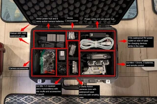

I added the power, but everything case-related is from Pelican. I drilled a hole and added a waterproof RV plug, then connected a 6 port USB power hub inside. Ran cable to all the places that needed charging. With everything connected I just had to run the extension cord to the wall and everything would charge. That whole kit I just sold because it was all 1st gen DJI stuff that I have since replaced.
All my newer DJI gear is in a bigger Pelican case, but I haven’t installed power to that one.
I also have a small version that stays in my car full time that contains my DJI Neo, Osmo Mobile 7P, Mic 2 and a Mic Mini. It has USB-c power plug on the outside that connects the car so when the car is running the gear is charging.

Just for personal. I can share the equipment.
USB Power Car FLuch Mount: Amazon.com: BATIGE 5/8" Round Hole Small Type C 3.1 Car Flush Mount Cable USB C 3.1 Panel Mount Male to Female Extension Cable for Car Truck Boat Motorcycle Dashboard 3ft : Electronics
USB Power Station:
- USB A: Amazon.com: Anker Charger, 60W 6 Port Charging Station, PowerPort 6 Multi USB Charger for iPhone 15/Pro/Pro Max/14/13, iPad Pro/Air/Mini, Galaxy S23/S22/S21, Note 20 Ultra, LG, HTC, and More : Cell Phones & Accessories
- USB-C: Amazon.com: Anker USB C 120W, 547 Charger, PowerPort III 4-Port Charging Station for MacBook Pro/Air, iPhone iPhone 15/15 Plus/15 Pro/15 Pro Max/14/13 Series, Galaxy, Pixel 4/3, iPad Series, and More Devices : Cell Phones & Accessories
USB Splitters
- USB-C
- Amazon.com: Anker Cable,4FT 2-in-1 USB C to USB C Cable 140W Max,Fast Charging for iPhone 16/16 Pro Max/15 Series,MacBook Air/Pro,and More(Braided,White) : Electronics (USB-C to 2 USB-C)
- Amazon.com: Charger for DJI Neo, Mini 4K, 2 SE, 3 Pro, 4 Pro, Air 2S, Avata, Mavic Drones - 3-in-1 USB Type C 3A Fast Charging Cable With 18W Adapter for DJI FPV Accessories, 4ft Long : Toys & Games (USB-A to 3 USB-C)
- Micro-USB: Amazon.com: Duttek USB to Micro USB Splitter Cable, 3 in 1 USB 2.0 A Male to Three Micro USB Male 1 to 3 Sync Charging Cable Adapter Cord (25CM/10 Inch) : Electronics (USB-A to 3 Micro USB)
The cases are Pelican cases. They are great, but can be spendy. Harbor Freight has some similar ones for a lot less.
The dividers inside the case are Pelican-specific. They are called TrekPak. They are amazing. In the black case, I was able to order the internals as a specific kit for that case. In the yellow case, I used some of the spare TrekPak I had to custom-cut my own internals.
Be careful cutting those holes. A mistake cannot be fixed.

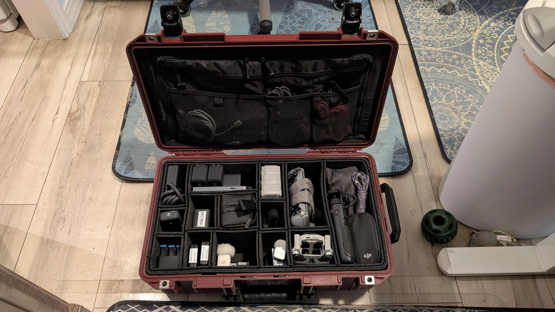

My current case does not have power, but I’m also not sure where I would put it right now. I put everything in a 1535 Air TRVL case that is made for carry-on. I chose that one because of that lid attachment. I am hesitant to mod it because of taking it on planes.
