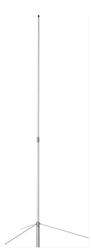

@Jensen
As a person who designs and builds commercial drones (in the 13.5kg range) I’d feel pretty confident in putting an antenna like this one in the air. While our drones don’t carry antennas for 2-Meter HAM, they do fly in winds upwards of 35 m/s without issue.
I don’t think this would be all that hard of a problem to solve.
