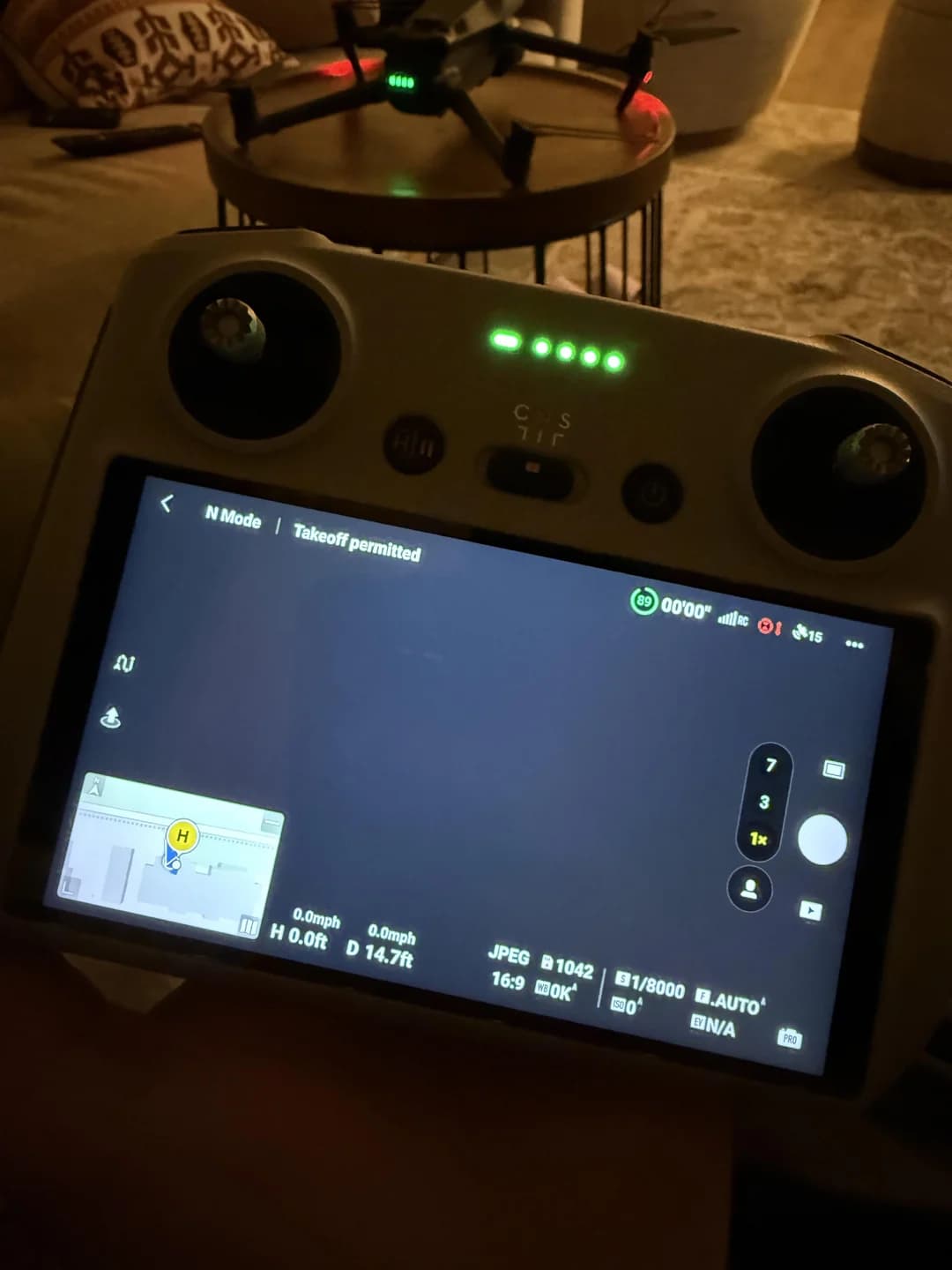

I just got my DJI Mavic 3 Pro from Amazon, but the camera screen is completely black. The drone connects fine, and takeoff is permitted—just no image from the camera.
Is this something simple to fix, or should I return it?

LOL, check your shutter settings—you’re probably on ISO Auto with a 1/8000 shutter speed.

It’s just Auto ISO, but the icon is really hard to spot.
@Soren
Ahhh, that makes sense. Weird way to label it.

LMAO, I was freaking out. Thank you for catching that!

Try switching the camera mode from Pro to Auto and see if that brings the feed back.
1/8000 shutter in a dark room… that’ll definitely give you a black screen.
