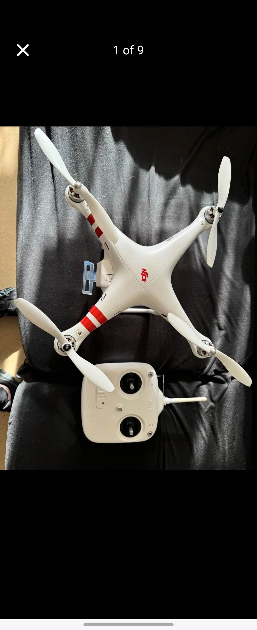

Is this $70 drone good for bait dropping while fishing?
Phantom 1? Nice. If it flies and works, go for it!

Are there bait droppers made for it?

Not really, you’d have to make one yourself. Also, depending on your location, you might need a permit to drop things from a drone.

If you can stretch your budget a bit, I’d go for a Phantom 3 or 4. Better range and overall a much better drone.

You don’t actually need a dropper.
You can plug a servo directly into the Naza flight controller—it has a spare channel. It’s originally for gimbal control, and you can adjust it in the Naza configurator on PC.
The only downside is that if you use a gimbal, both the servo and the camera movement will share the same channel.
If you go this route, you might need one of those cheap gimbal control thumb dials that attach to the back of the controller.
Phantom 2s actually have this feature from the factory.
