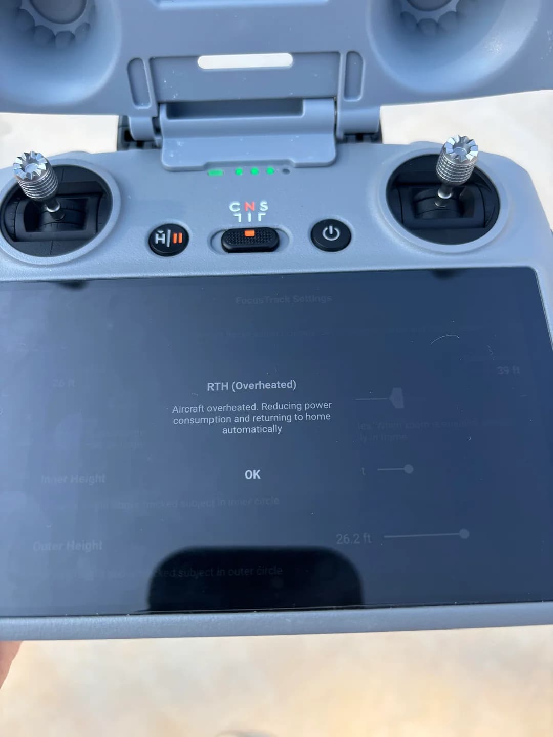

My Mini 4 Pro recently has been overheating a lot more consistently, with the warning of “cpu overheating”, I’m flying it with active track and other modes, not staying still and letting the air cool it as it flies as it’s supposed to, all of a sudden it wants to land since it’s overheating. Is there a fix that’s easy for it?

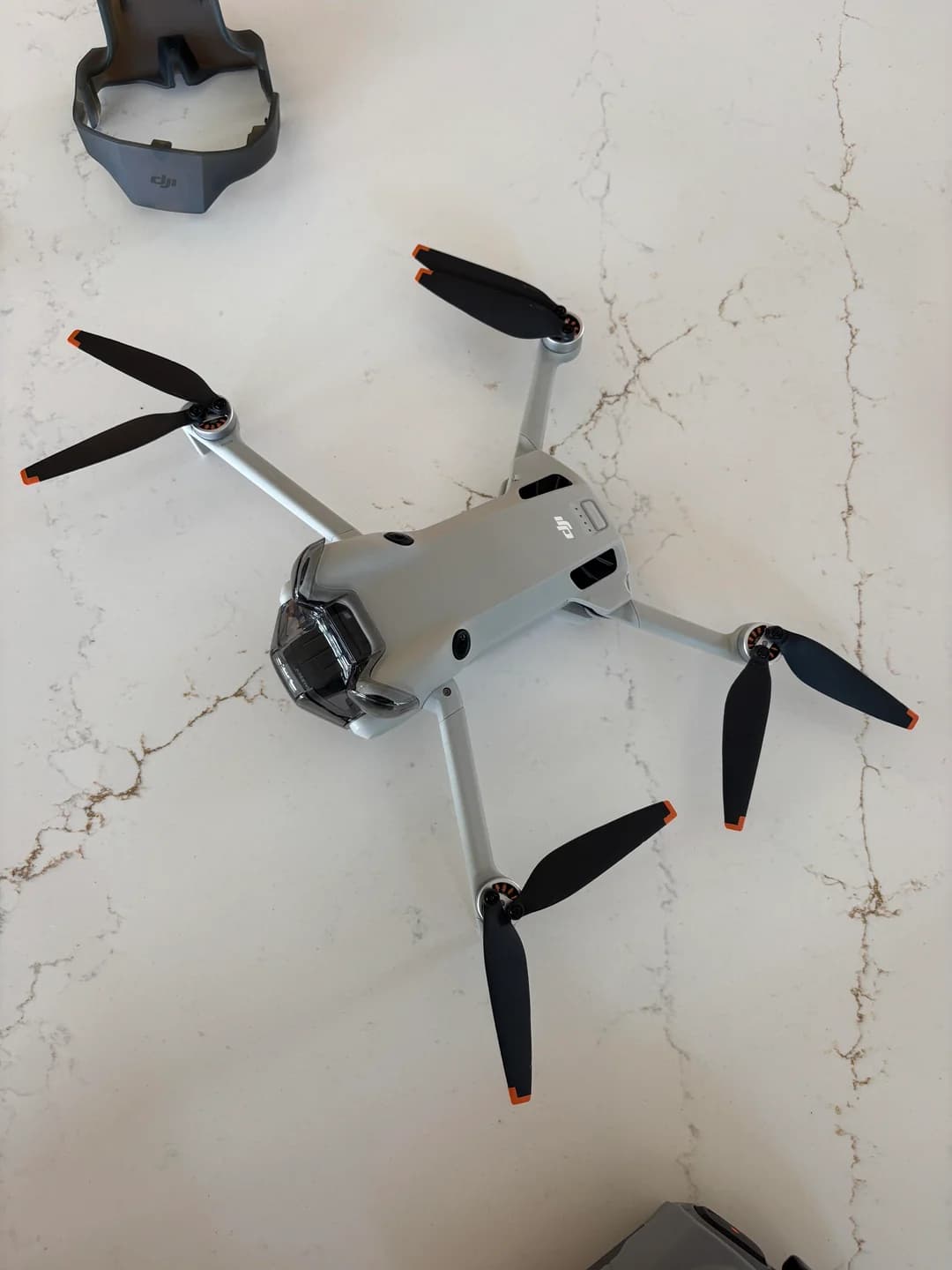

You didn’t fly with the gimbal cover still on, did you?
Nah, that pic was taken after the flight lol.
Was gonna ask the same thing!

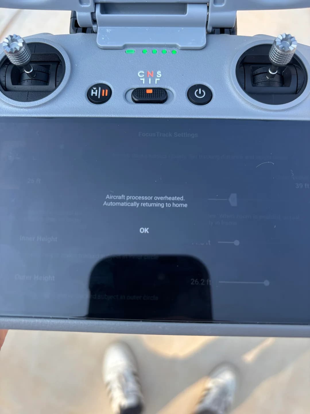

It says ‘Aircraft Processor Overheated’—that’s not a battery issue.
