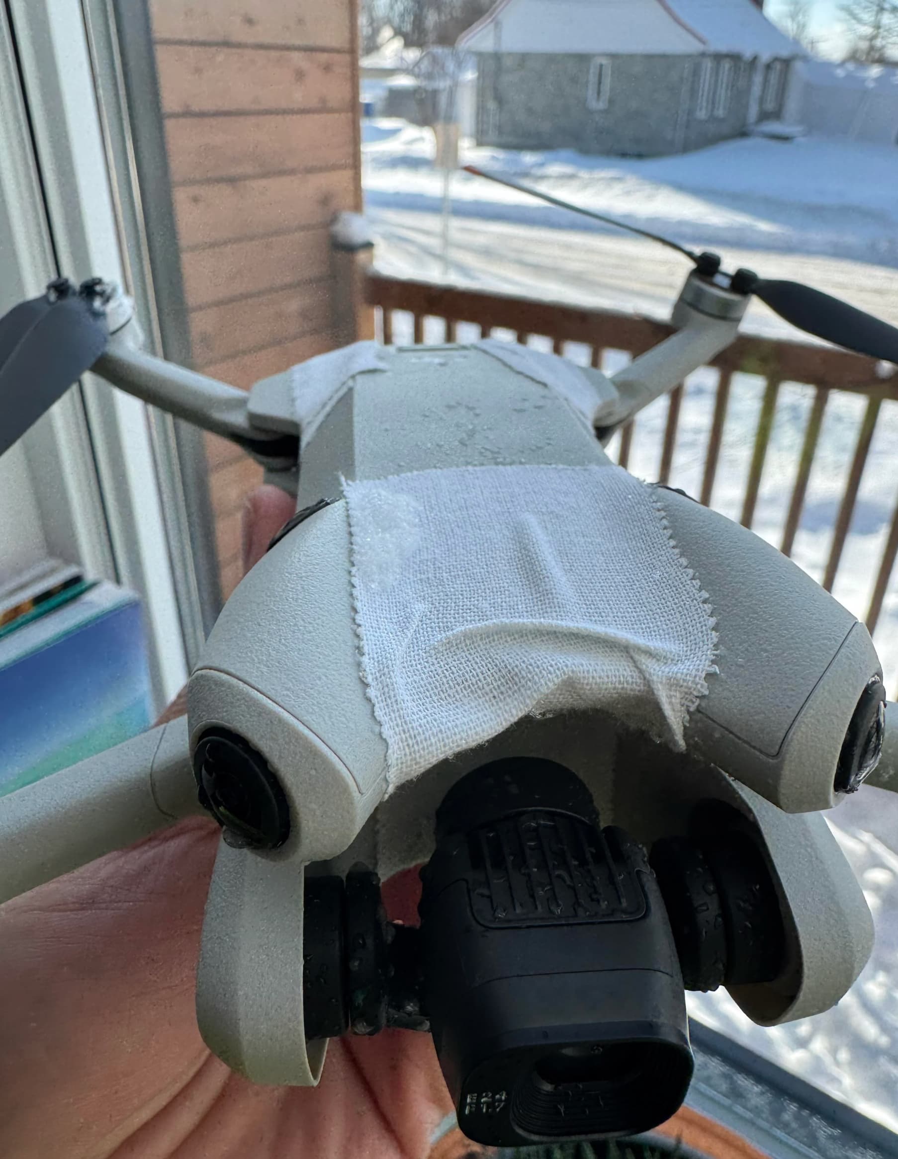

Dude put a bandaid on the lil guy :joy:

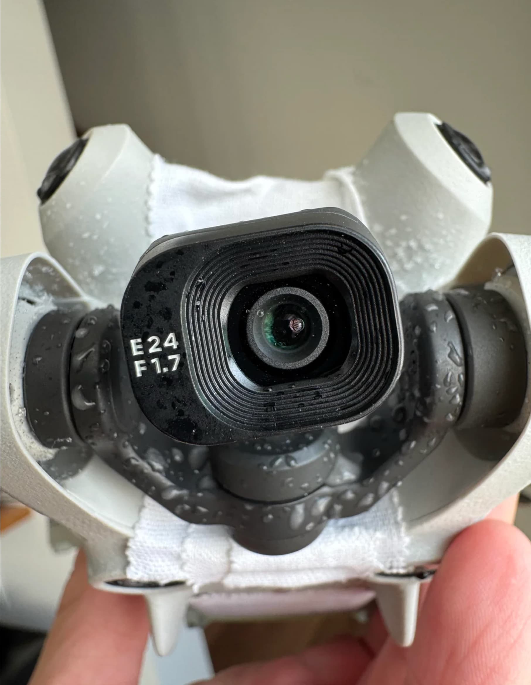

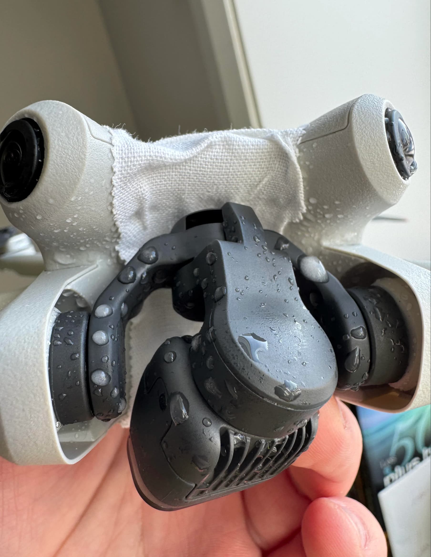

What is the cloth tape for?

It’s a blanket to keep the drone warm

Blocking the cooling vents, helps to keep the warmth a little longer. I warmed up the batteries inside at home from 100% to 95%.

That’s a good idea. I was flying my mini 2 last night in 20F and even though the batts were warm I didn’t get much time out of them.

I get about 10-15min less time in this kind of cold and lately it’s been so nice out but too bloody cold for the drone. -25C is too cold for long flights but if there was minimal wind and I had a place in mind to get some pics/video I’d be fine.
Disable your sensors too next time. Ice buildup on them will make the drone panic

So that’s what it is. The panic is good in a way that it made me bring it back sooner :joy: (under 2min)

Yep! Ice build up and flying low over water (like going under a bridge) are when I disable sensor
