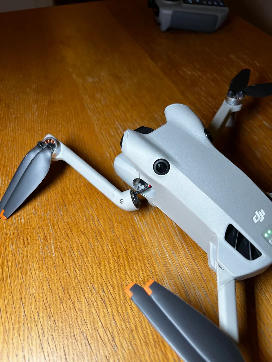

Is this something I can fix myself? Or how do I go about making it work again? Drone still starts as normal and no error codes show up in DJI Fly.
It fell from two meters while being folded out.

Looks like the ARM AXIS is broken. This should be an easy fix for about $10. A DIY job with just 5 screws.
The part you need is called the Mini 4 pro front rotating axis. You will need a specific screwdriver, but the repair isn’t hard. It shouldn’t take more than 5 minutes.
Just watch out not to drop any screws inside the drone; that could turn it into a bigger task.

You need a T5 torx screwdriver. It’s not exactly special, but not everyone has one in their toolkit.

It’s the front arm axis. This part is common to Mini 3, 3 Pro and 4 Pro. It costs about €5 to €10. Just need a quality T5 torx screwdriver to remove 5 screws. No need for soldering or any electrical experience despite what people might say.
If you know what you’re doing, you can totally fix it yourself.

If you can’t access DJI support, this is a pretty straightforward fix. There are lots of YouTube tutorials, and you’ll just need to buy a replacement arm hinge that shouldn’t cost more than 10 bucks. I fixed mine in less than half an hour.
