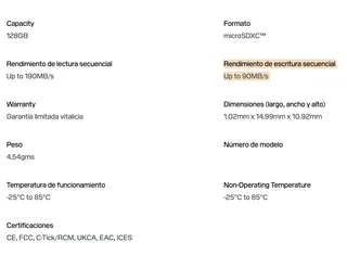

That 128GB model might not handle the 100MB/s bitrate the Mini 4K needs for 4K video. It’s rated up to 90MB/s on paper, but that’s ideal conditions. You should check your card’s real write speed with a USB 3.0 reader and port. Using USB 2.0 gives wrong results.
Always check exact specs on the brand’s site for your card’s model and size, same with SSDs.

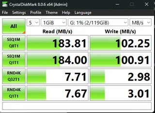

@Reese
Those speeds look okay, but remember it’s a quick test. When the card is in the drone, writing nonstop for minutes near a hot battery, speed can drop.

@Shannon
That’s disappointing since the seller said this SD card was made for drones and even had a symbol on the package. I didn’t know about the 100MB/s bitrate need. I’ll check the card speed with my USB 3 port and reader.
