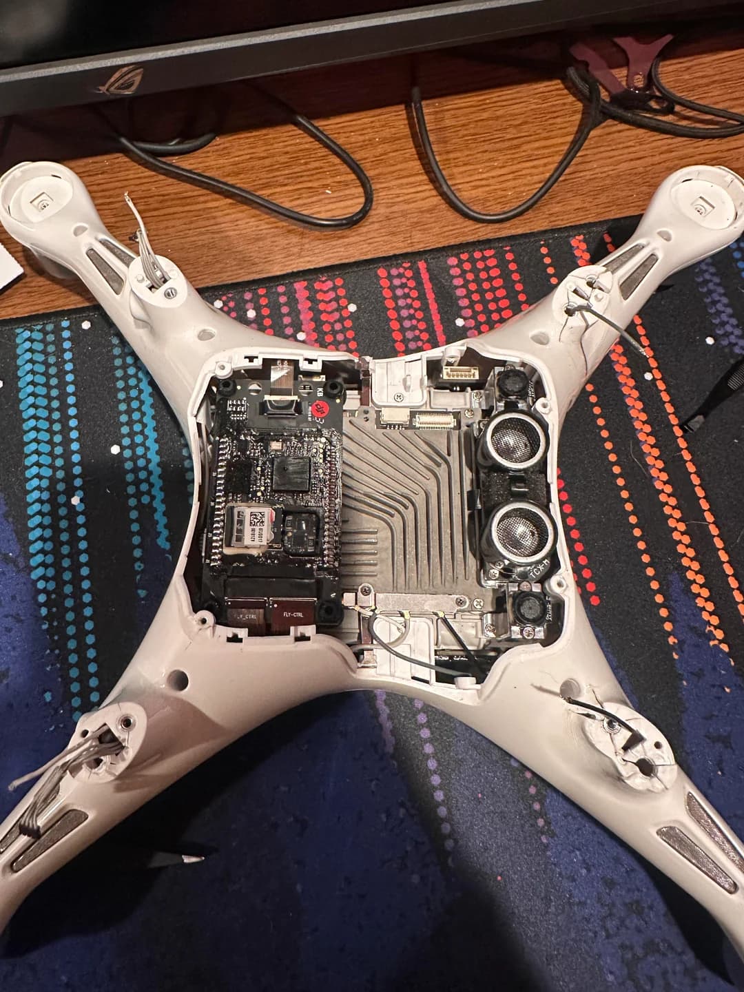

I recently traded into a Phantom 4 model number WM330A. I was damaged dew to previous owners kid go ahold of it and pulled the landing gear off, damaging the landing gear and the middle shell. I’m pretty handy and got a good trade so I picked it up. Got onto eBay and bought a middle shell and landing gear(bought from 2 separate dealers) that said they were new genuine products for a Phantom 4, not a 4pro or adv, when I got everything in the middle shell looks right, but during tear down, I pulled out the landing gear I was sent and they appear to be wrong and they didn’t include the wires I need to replace going to the landing gear either. So in the end, was I sent the wrong item, or do I have the model of my drone wrong?
I picked up a P4 last winter too but haven’t opened it up yet. Mine’s also having issues calibrating the compass, and when I took the gimbal off to peek inside, I noticed some moisture scaling on the circuits. I wasn’t totally sure what you were asking since the pics didn’t explain much, but for what you’re describing, parts should be swappable between most of the P4 models. Major differences were usually in the camera, ESC, and motors.

Yeah, sorry—my post was kind of a mess. I’ve watched a bunch of teardown videos and I’ve got experience with tech repairs and RC cars/trucks, so tools aren’t an issue. I’m just new to drones, and I don’t know if I’ve ID’d this model right. Everything I’ve read points to it being a regular Phantom 4, but the landing gear I bought (listed as fitting a standard P4) doesn’t even come close to lining up. So now I’m not sure if I got the wrong part or if I’ve misidentified the drone.
@Ali
Totally understandable—it happens a lot with this stuff. I’ve got the WM330A model too. The body shapes and leg mounts can be different across versions even if they look super similar.

And thanks for confirming, WM330A is the standard Phantom 4, not Pro or Advanced, right?

Here’s the breakdown on Phantom 4 models by number:
WM330A – Phantom 4
WM331A – Phantom 4 Pro
WM331S – Phantom 4 Pro V2
WM332A – Phantom 4 Advanced
Controller compatibility’s also its own rabbit hole.
SOURCE – Determining exact model of P4? | DJI Phantom Drone Forum

DM me if you’re still unsure about your model. I ordered both Pro and standard shells, but mine turned out to just be a P4. If you happen to need Pro shells, I’ve got them—$35 plus shipping.
Edit: Actually never mind, sounds like you’ve got the same model I do. Pretty sure they sent you the wrong landing gear.
