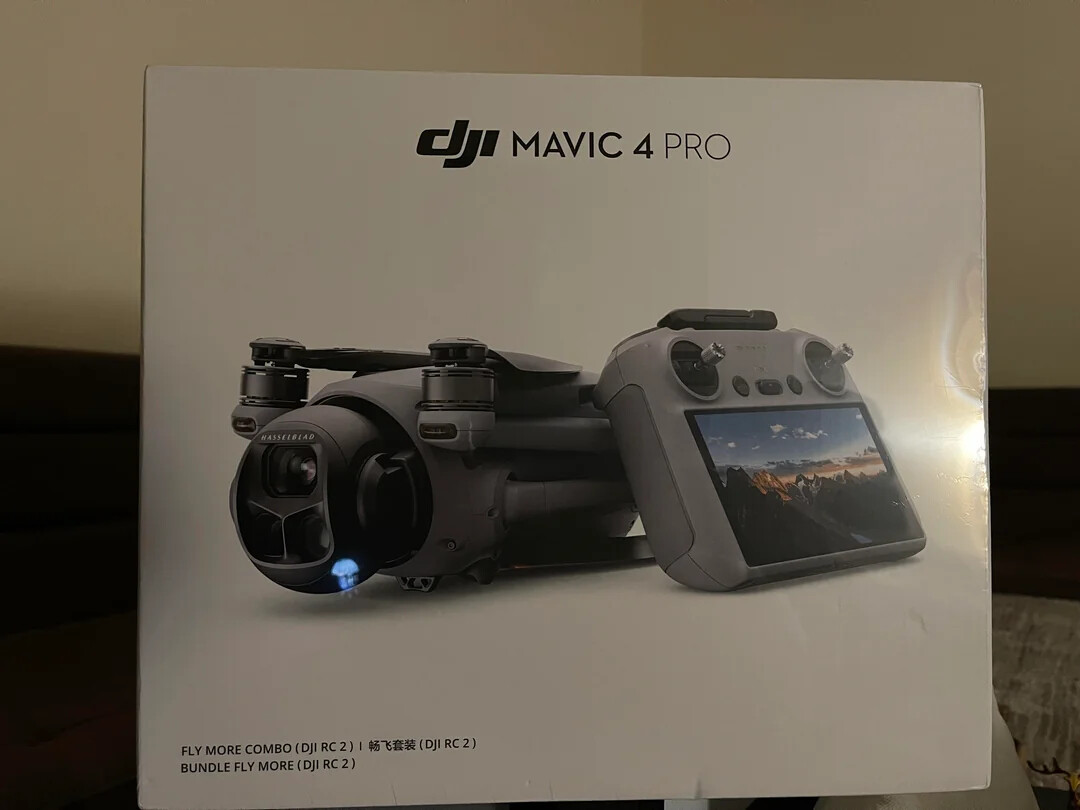

Just got my M4P with fly more combo One thing I didn’t know about that this version doesn’t ship with the 240w charger … tried to search for stores online but couldn’t find any that ship worldwide or at least my country ( Saudi Arabia )

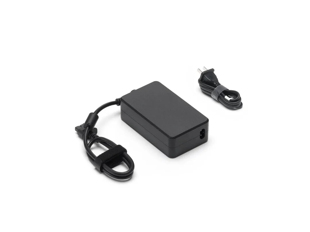

From the pic above, it doesn’t look like the DJI 240w one uses USB-C. It looks like some custom cable that hooks up to their battery hub.

It actually does have USB-C. I’ve got one. There’s one USB-C port and one special port—you can use either one to charge the hub.

Do you know if the USB-C on that charger gives full 240w? I don’t think it does. Looks like it only gives about 65w.
Edit:
I checked the specs—USB-C only does 65w. To get full 240w, you have to use the special plug.
“Output: Up to 240 W (total), up to 65 W (USB-C)*”

The Mavic 4 charger hub has two inputs—one normal USB-C and one smaller SDC plug for the official 240w DJI charger.

Look at the photo more closely—it’s not a regular cable. This one’s made specifically for DJI’s hub. Regular 240w bricks won’t fit right.

You can still use any 100w USB-C charger. But if you want true fast charging at 240w, you’ll need DJI’s charger with the mini SDC plug.

That’s a nice looking box
