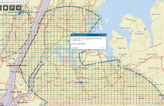

(If you’re in the US) You can check FAA maps to see which areas need authorization:
https://faa.maps.arcgis.com/apps/webappviewer/index.html?id=9c2e4406710048e19806ebf6a06754ad

If you drop a Google Maps link, I can check if that location actually needs FAA approval.
DJI recently updated their maps to match the FAA database. If your FlySafe database is current, then that spot likely needs FAA permission, which you can request through LAANC apps or the FAA Drone Zone site.

Here’s the link: Google
I was just testing my drone while my son rode his little dirt bike.
@Kei
Yeah so that is a 0 no fly zone because you are in Class B airspace Controlled by LaGuardia Airport.
Class B airspace is not eligible for LAANC auto approval.
The proper process is to go to FAADroneZone and request an airspace authorization 60 days before you need to fly there.
And I am not sure if they would approve it because it is Class B airspace.
Your best option might be to go fly at a park outside of the no fly zone such as the Pelham Bay Park Area.
